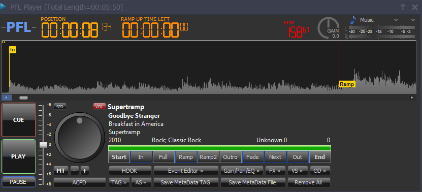

I think I must have made a mistake somewhere: for my tests, I selected 5 test tracks on which I created a "Ramp" point just before the vocals start. Then, I created a test script with 5 lines, where I inserted my tracks in Random mode, using filters to make sure the system would schedule the test tracks. After that, using the little Flash button, I set up the "Automatic Track Insert Transition Option," choosing "None" for the mode and my "Sweepers" folder. Finally, I generated a program in which my test tracks are played. And there, I can clearly see the white bar indicating the Ramp, but no sweepers are being played.

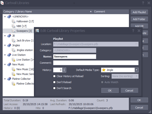

Please post an example, ie a screenshot. And how many and what tracks are contained in your cartwall lib you selected for your sweepers.

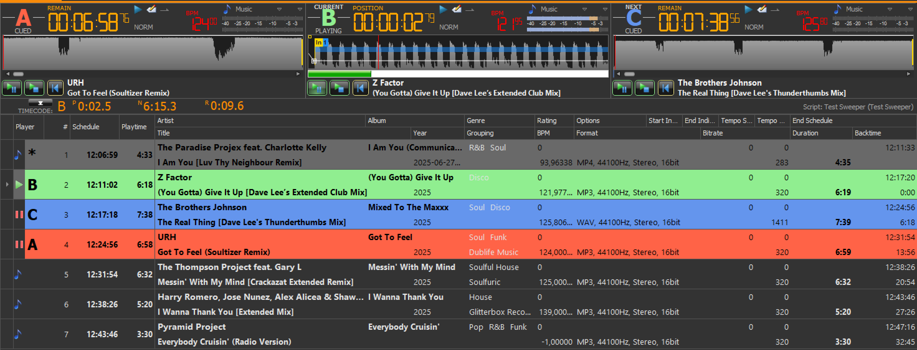

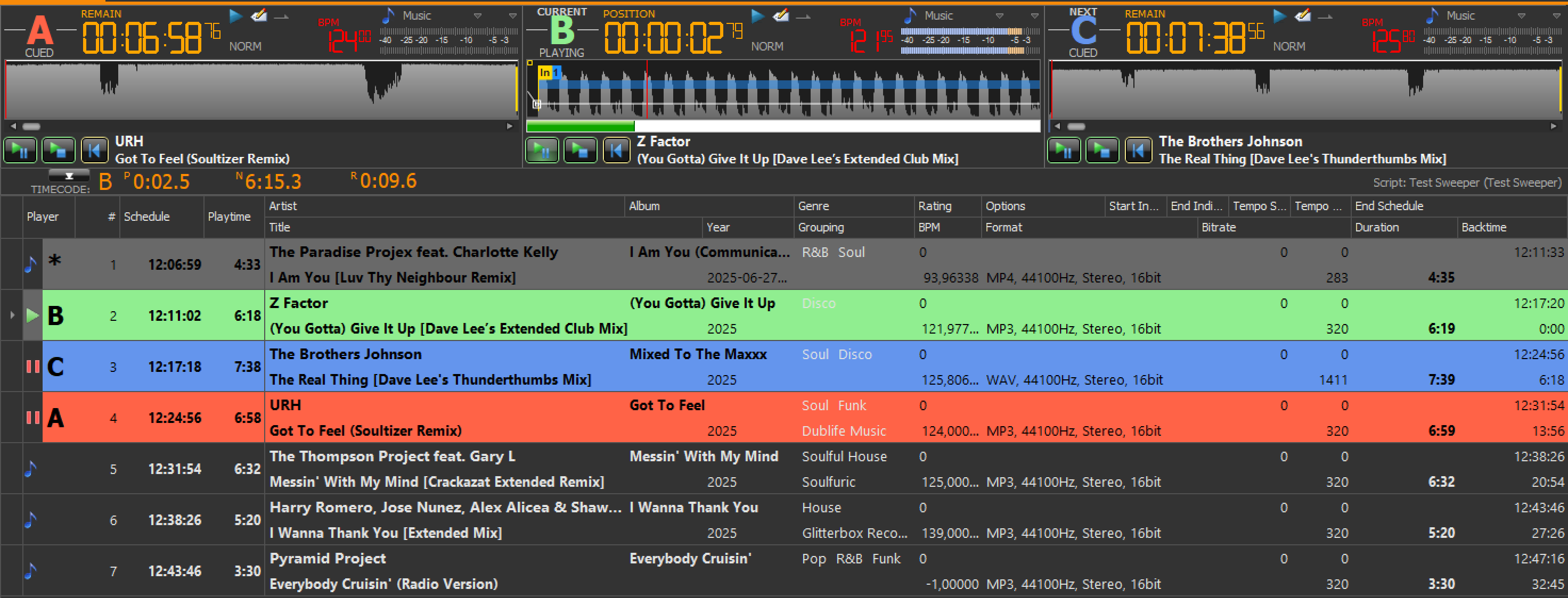

I just made a small test myself and all was working. My script just used an "Auto. Sweeper" for each 2nd track in the script. Here is the result (i.e. the 2nd track loaded to player B):
You can see, that a track-insert was performed and the sweeper was added (see the volume valley and the blue line in the original track.

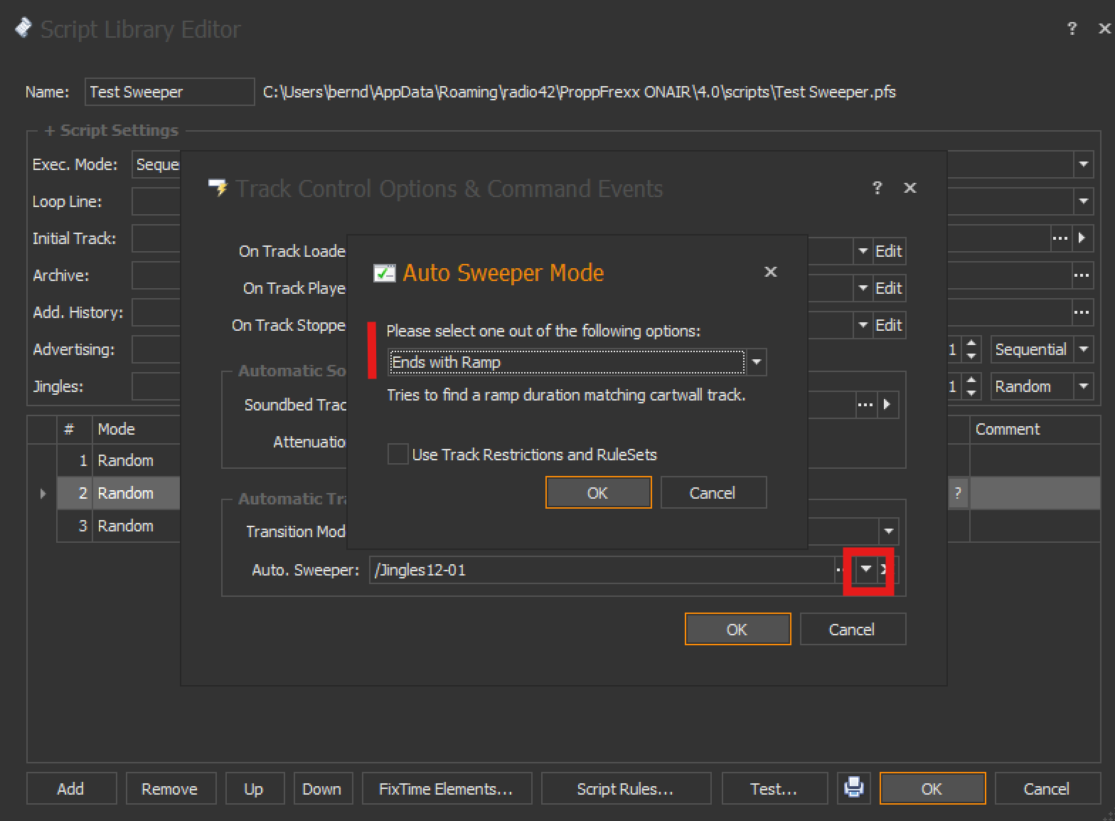

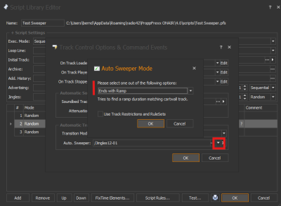

Also note, that you can change the Auto Sweeper Mode in the script-line option using the arrow down button next to the auto sweeper...

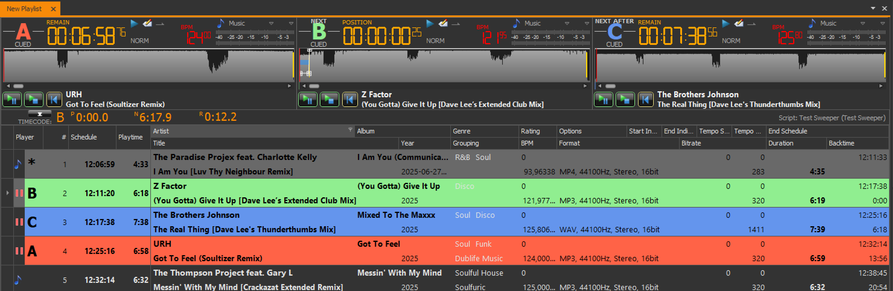

Here are the screenshots of an example track with the Ramp mix point, my library of sweepers for the test, and my script. I selected 4 tracks and 3 sweepers for the test.
Posts: 9160
Re: Insert automatically sweepers on intros.
But from where did you start the PFL Player?
It doesn't look, that it is coming from your 2nd script-line - e.g. put the column "Source Info" into your playlist window view...
Why do I believe this?
You defined the 'Auto. Sweeper' for your 2nd script-line. But the "Supertramp - Goodby Stranger" track doesn't match your filter criteria's defined in the script.
Note, that the Auto. Sweeper would only be applied, when you execute that script.
Also note, that a LoadPlaylist command wouldn't execute and sweepers on top... it just loads that playlist.

1/ Yes, sorry for that mistake when taking the screenshots, but during my tests, it was indeed "Goodbye Stranger" that was playing.
I started the PFL from the Meta Data Editor to determine the Ramp point.

2/ I noticed in your video that you set “Ends with Ramp” instead of “Transition Mode: none” like in my screenshot. Could that be the issue?
Posts: 9160
No. You probably didn’t get my message. I was using the Auto. Sweeper. But as written in my previous post, you can also define the Auto.Sweeper mode - and I just used the default.
