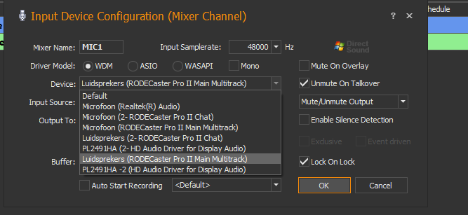

i have now an mono sound, but i have also set stereotool. the stream is on daytime on auto dj. im writing on 23.52 dutch time. the sound is not good on mono. only flac from cd.

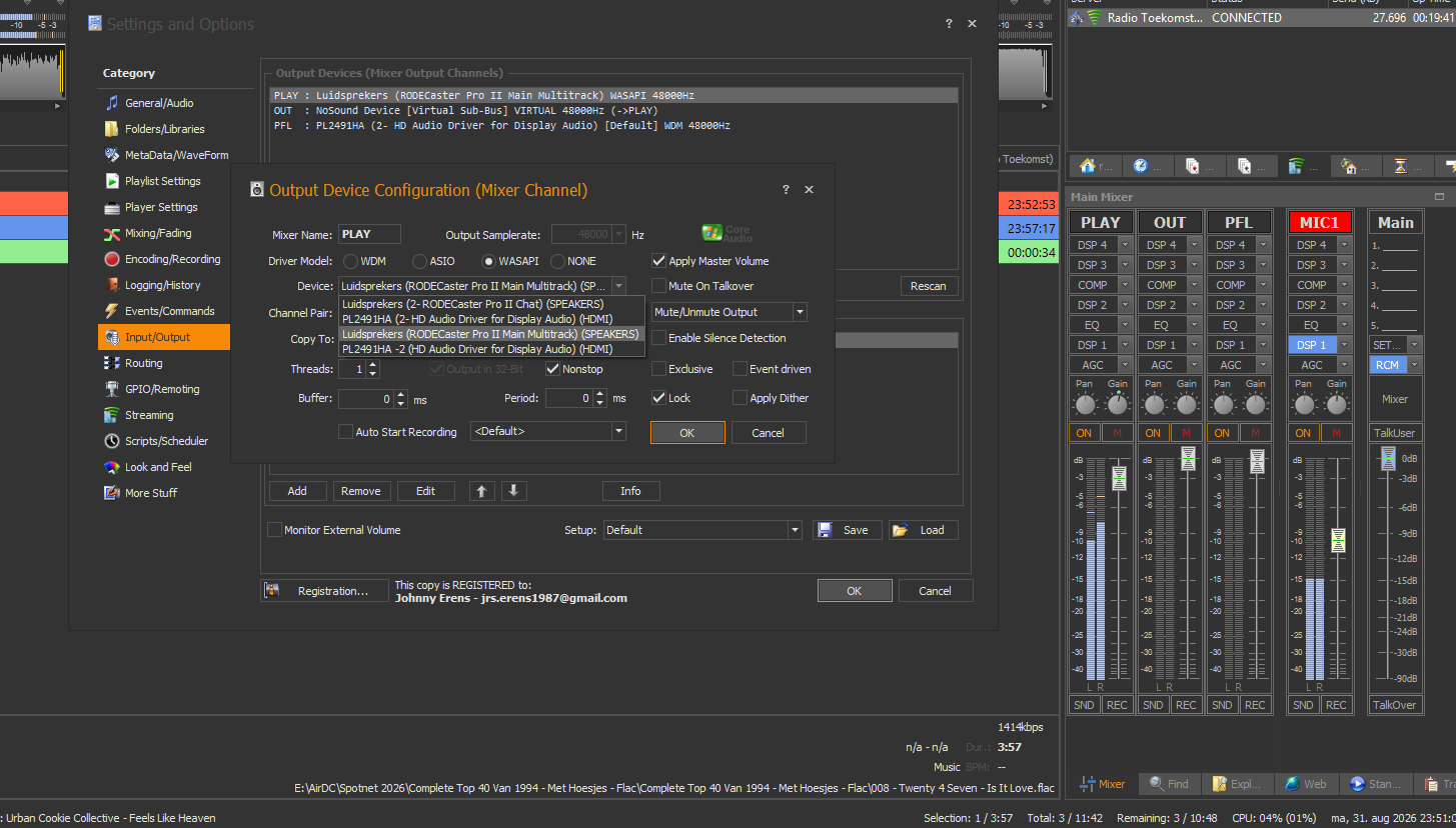

when i change to that, then is stereo but oceansounds. and i ant not talk or play music on my mixer. the live. the sound always same. strangs.

You have posted an input and an output mixer channel settings.
Is you problem, that the MIC signel is Mono?
If yes, note, that any Microphone is always mono.
But in your Input settings, you finally selected the Rodcaster output as the recording device instead of the Microphone?!
That doesn’t seem to make sense.
Also note, that you should not mix the device modes. Ie. use WASAPI on all devices.

So I am guessing your mic input channel is mono?
For your Input Mixer Channel:
Use the Microfoon Rodecaster Pro II device!
Route the single to an output channel (eg. PLAY).
Set the processing either to Stereo or Normal Mono (right-click on the input channel name and select Processing…).
Set the StereoTools VST on the output mixer channel and not the input mixer channel.
For the Output Mixer Channel don‘t use the Rodecaster device, but any other audio device.
